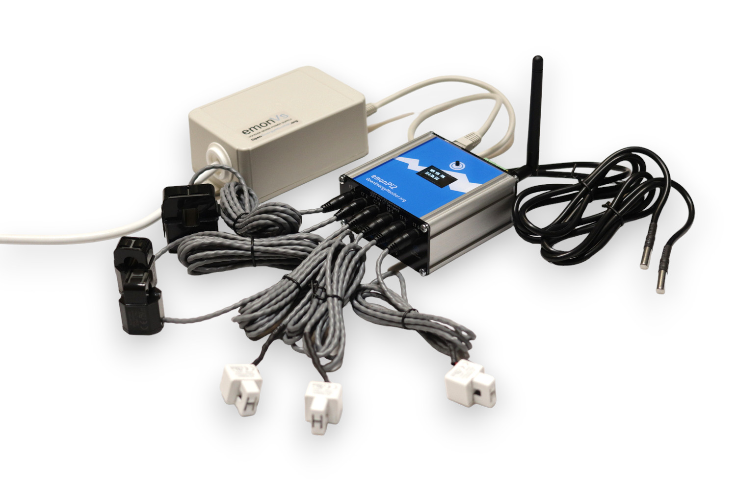

The following guide covers installation of the emonPi3 and emonTx6 6x CT input energy monitor.
Hardware covered in this guide:
RJ45 voltage sensor and power supply cable
Up to 6 CT sensors

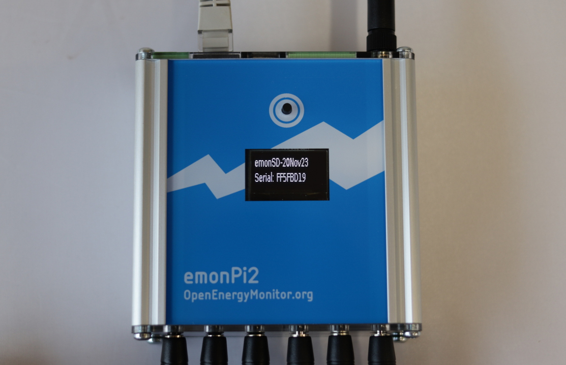

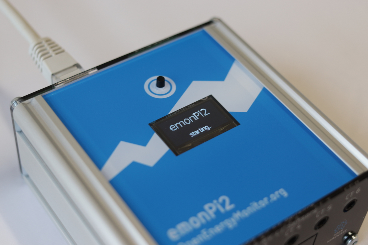

The emonPi3/emonTx6 indicator LED will be red and then turn green after ~1 s if all the initialisation is successful.
(emonPi3 only) The display on the emonPi3 will show
emonPi3 version git-hash(the exact version and git-hash will depend on the firmware version in use). On the SD card side of the case the Raspberry Pi 4 indicator LED should be visible through the smoked face plate.(emonPi3 only) If using Ethernet, continue with Connecting via Ethernet. If using WiFi, continue with Connecting via WiFi.

Current transformers (CTs) are sensors that measure alternating current (AC).
The emonPi3/emonTx6 supports a wide variety of 333 mV voltage output CT sensors. We stock 20 A, 50 A, 100 A, and 200 A options in the OpenEnergyMonitor shop. The physical size of these CT sensors is also roughly proportional to their current rating. For highest accuracy it’s a good idea to choose CT sensors that match the rating of the circuit being monitored. As an example a 20 A CT should be used for 16 A or 20 A circuits, a 50 A CT for 32 A EV chargers or 100 A CT for whole house monitoring (assuming a 100 A rated supply).
CT sensors need to be clipped around the Live OR Neutral cable of the AC circuit to be measured (not both). The CT sensors have an indicated direction printed on the case
K->L, where L is the direction of the load. That’s on the Line conductor, the arrow points away from the load on the Neutral. This will ensure the correct sign (+/-) on the power readings.Take care not to compress the sensor with any sideways force as this can affect the accuracy of the measurement.
The new range of CT sensors used with the emonPi3/emonTx6 are all voltage output CT sensors with integrated burden resistors and so are safe to clip on to the circuits that you wish to measure before plugging into the emonPi3/emonTx6 if that makes installation easier.
The emonPi3/emonTx6 requires voltage output CT sensors by default. There are 6.8Ω burden resistors included for use with current output sensors, for example the YHDC (blue) 100 A CTs. To use these burden resistors, users can bridge the solder pads next to the 3.5 mm jack. Each CT input channel is independent, so you can have a mix of current and voltage output CTs in use.
Note the CT sensor used on each circuit, as well as the channel number on the emonPi3/emonTx6 that the CT is connected to, as this may be required to calibrate the emonPi3/emonTx6 if you are using non standard CT ratings. It’s worth making a physical note of this on a label next to the emonPi3/emonTx6 for future reference.

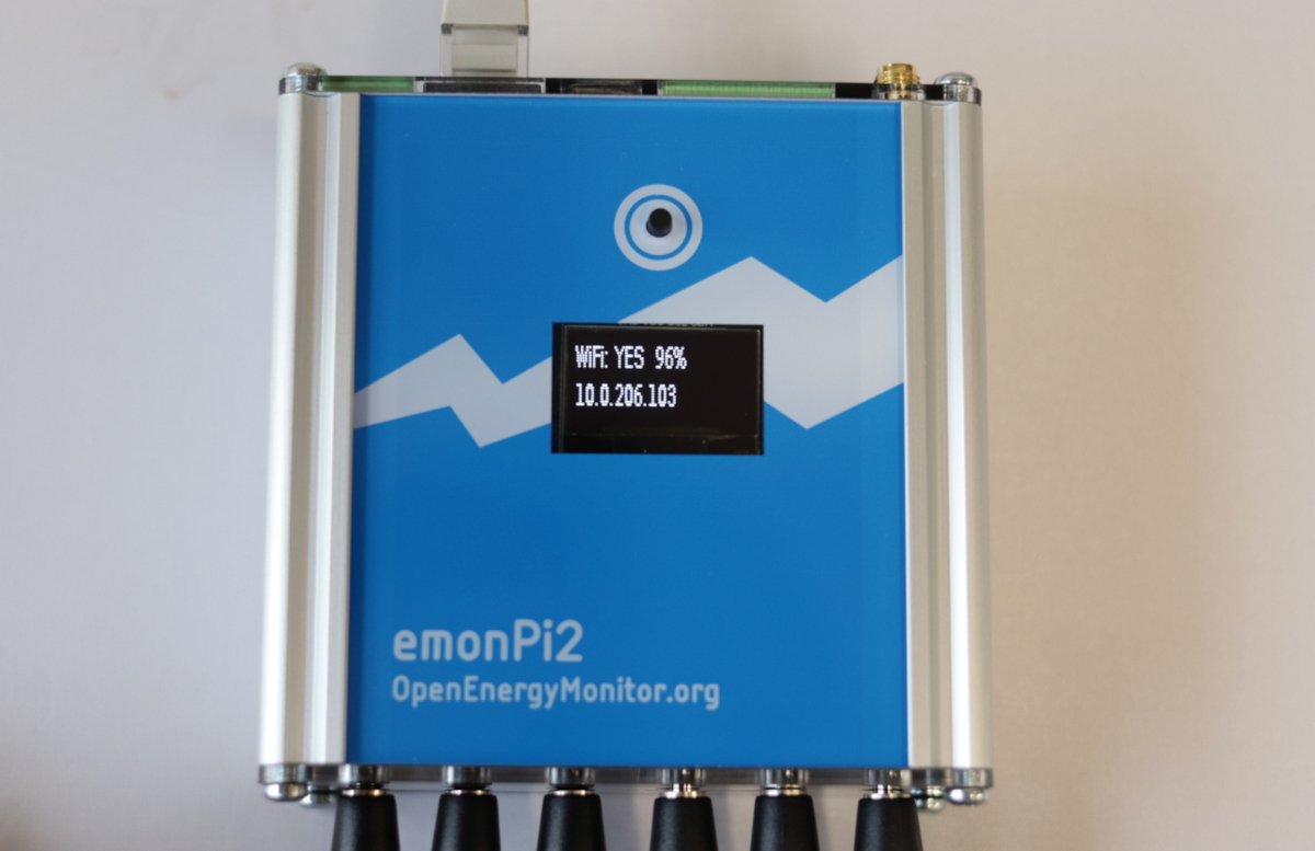

If a wired ethernet connection is available and you have the emonPi3 hardware that supports Ethernet (e.g Raspberry Pi 4 shop option), this provides the most reliable result. We recommend using shielded Ethernet cable to reduce potential electromagnetic interference. Simply plug the Ethernet cable into the Ethernet port found next to the USB ports and CT sensor inputs.
Scroll to page 3 on the emonPi3 display to find the assigned IP address.

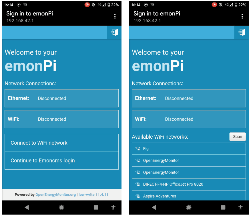

Connecting via WiFi
When the emonPi3 is powered up it will create a WiFi Access Point called emonPi. Connect to this using password emonpi2016. On Android devices a captive portal option should pop up with the option to ‘Sign in’. This will bring up the Wi-Fi configuration interface.
Note
Captive portal and the new WiFi setup interface is available on emonSD_01Feb24 or newer. You may wish to upgrade to the latest emonSD image see the emonSD download section.
Note
While captive portal generally works well on Android phones, the current software version may not always provide a consistent captive portal ‘Sign in’ popup on other devices and browsers. If no ‘Sign in’ option appears browse manually to the IP address http://192.168.42.1.

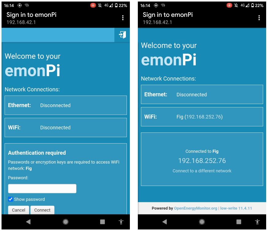

1. Click on ‘Connect to WiFi network’ to show the list of available WiFi networks. Click on the network that you wish to connect to.
2. Enter the WiFi network passkey (often found at the back of the internet router). Click connect. Connecting to a network and relaying the status update back to the user interface typically takes around 20 seconds. Note down the assigned IP address and use this to connect to your emonPi3 once you are connected back to your home WiFi network.
Note
The Pi Zero 2W hardware option will usually drop the access point WiFi connection a few seconds after clicking ‘Connect’. Wait a few seconds, disable and re-enable WiFi on your phone, connect to the emonPi access point again and then bring up the network configuration interface via the ‘Sign in’ captive portal if available. The connection status and IP address can be accessed by reconnecing to the access point in this way.
The WiFi IP address can also be accessed by scrolling to page 4 on the emonPi LCD:
The emonPi3 will now present the emoncms login screen. If the Register button is not shown, login with default account username emonsd and password emonsd. We recommend changing the default username and password from the My Account page once logged in.

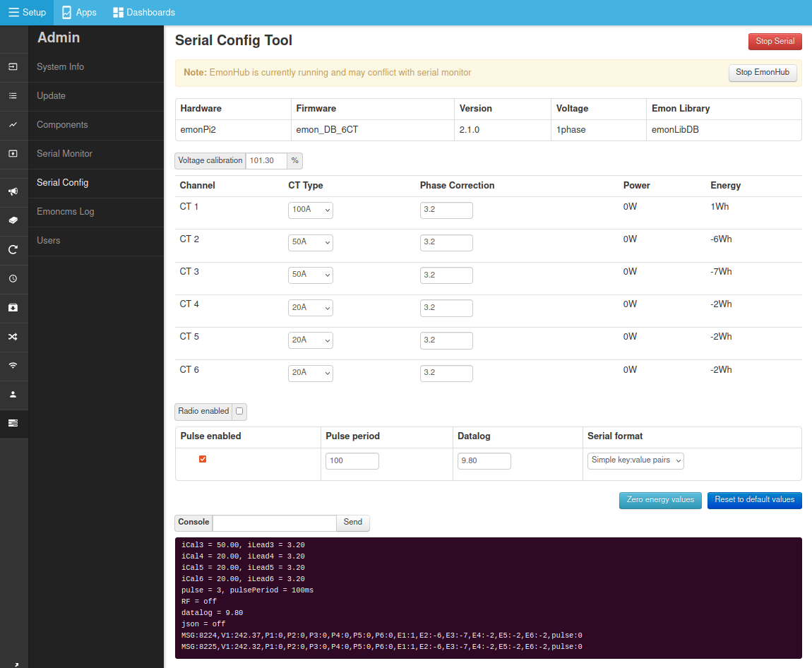

CT calibration selection
Different rating CT sensors e.g 100 A, 50 A, 20 A etc, require differant preset calibrations.
CT calibration is usually pre-configured in the shop as part of the order process, but you may wish to double check that your calibration configuration matches the sockets that you have plugged the CT sensors into at this point.
Navigate to
Setup > Admin > Serial ConfigClick on
Stop EmonHubto temporarily stop the EmonHub service while we perform calibration.Select serial port
/dev/ttyS0and clickConnect.After a couple of seconds the emonPi3 will print out its current configuration which will populate the interface (if it does not do this type
land clickSendto reload the calibration details from the emonPi3 measurement board).Adjust the CT rating to match the CT sensor that you have installed on each channel.
Click on
Save Changesto ensure that the new configuration is recorded such that it persists when you power cycle the board.When finished, click on
Stop Serialto disconnect the serial configuration tool and thenStart EmonHubto restart the EmonHub service.

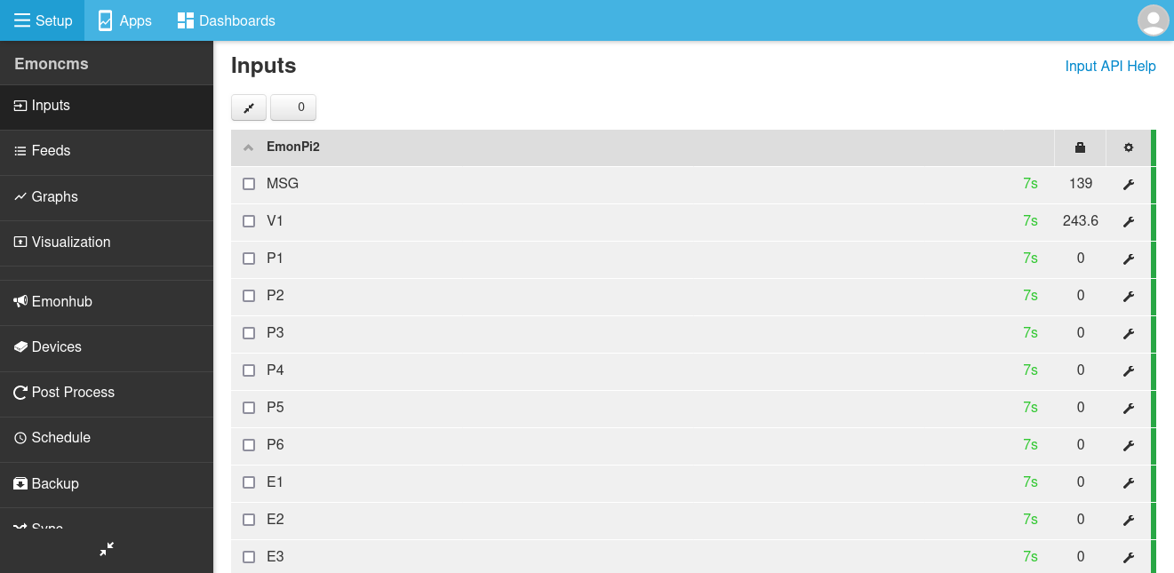

Setup input and feeds
Configure inputs by navigating to Setup > Inputs. The emonPi3 will pop up here automatically under the EmonPi3 node name.
The next step is to log the input data to feeds. Inputs are just placeholders showing the latest values sent from the emonPi3, we need to create feeds if we want to record a time-series of these values. It’s possible to either manually configure each input as required, or if you just want to record everything for now and delete what you don’t need later, then you can use the pre-configured Device Template.
Tip
Input configuration using the emonPi3 device template: On the Setup > Inputs page, Click on the cog icon (top right corner) of the emonPi3 node. The ‘Configure Device’ window will appear, click on ‘emonPi3 Standard’, you may need to scroll down a little in the Devices pane to find. Click ‘Save’ and ‘Initialize’. This will create feeds that record real power and cumulative energy for each channel, Vrms, total message count, temperatures and total pulse count. Navigate to Setup > Feeds to see these feeds.
Manual input configuration: You may only want to record specific channels or apply more complex input processing.
With feeds created, explore the data using the graph view. Navigate to Setup > Feeds and click on a feed of interest to open the graph view. Click on the drop down time selector near the title and select the last hour. Click and drag to zoom further to see the new data coming in.
