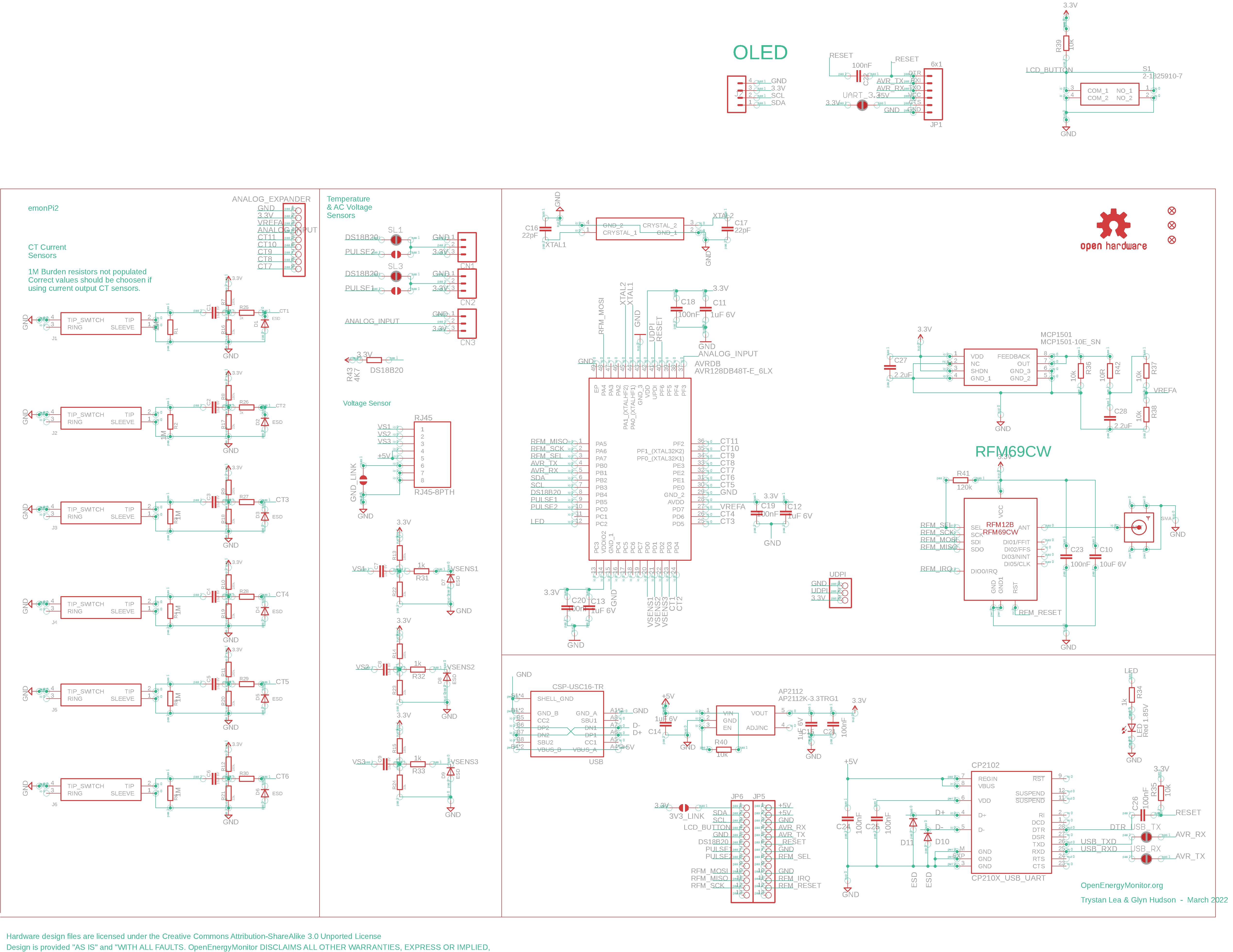

Hardware
Schematic

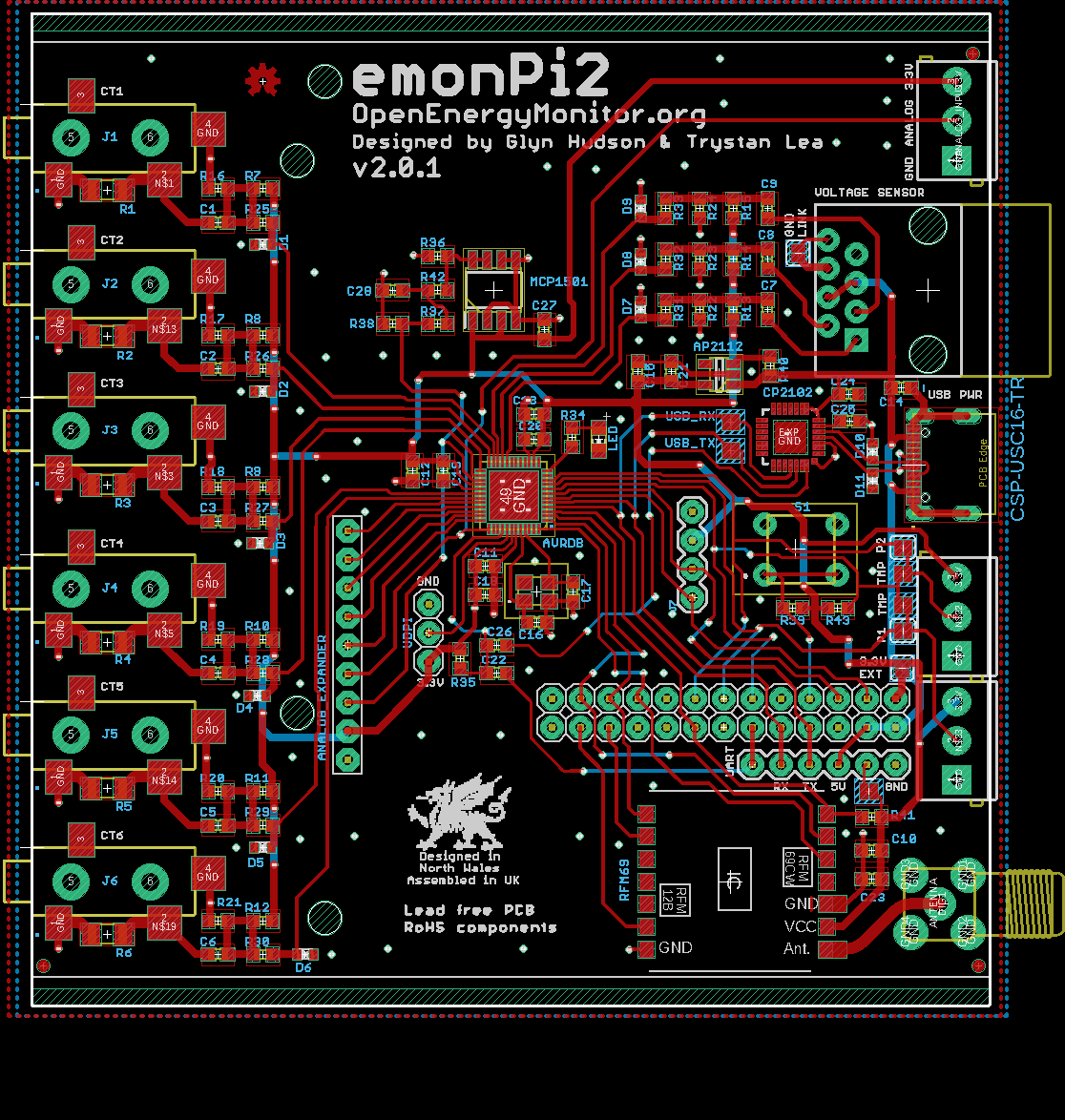

Board layout

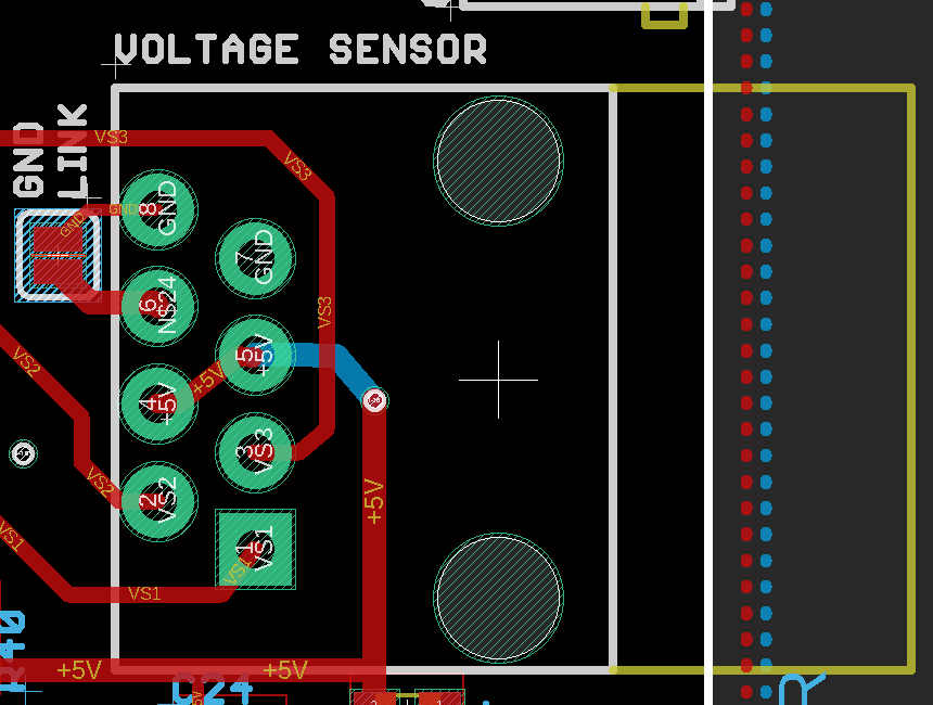

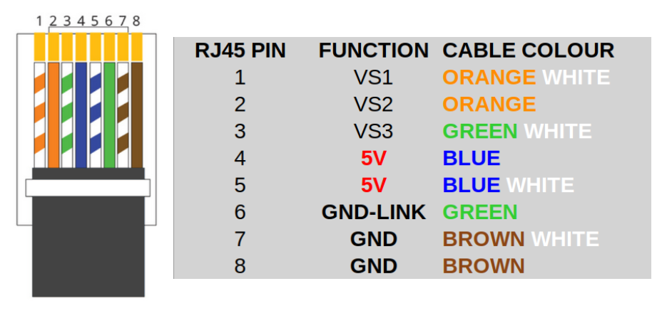

Voltage sensor pinout
