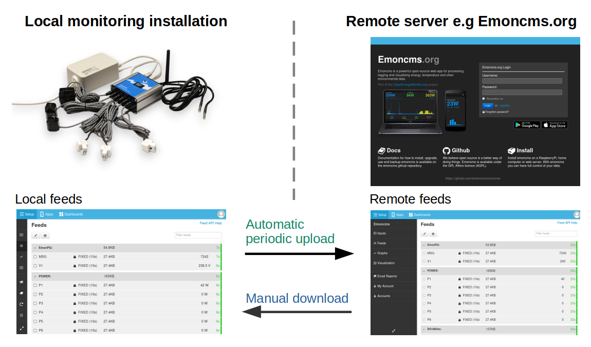

The sync module copies feed data between two Emoncms servers. Typically these are an emonPi or emonBase at home and a remote server such as emoncms.org. Open it from Setup > Sync on the local system.
Sync overview
Upload or download
Upload sends local feeds to the remote server at a set interval. Set up input processing once, on the emonPi or emonBase. The remote server receives the resulting feeds. This replaces sending input data with emonHub, which needs input processing set up on both systems.
Uploads send data in binary, which uses little bandwidth. If the internet connection drops, data is still recorded locally and uploads resume when it returns.
Download copies feeds from the remote server to the local system once. Use it to recover data after an SD card failure, to keep a local copy, or to move from remote to local logging. Downloads do not repeat.
