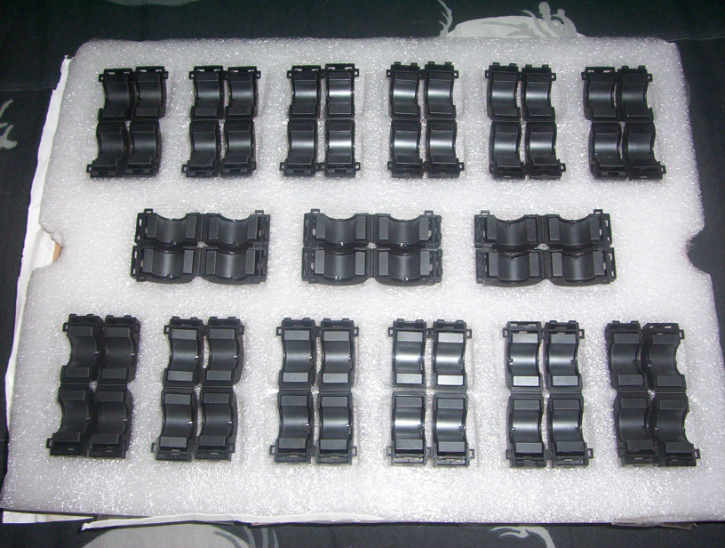

Sensing current
Image 1 – Clip-on CT sensor.
UK: Whole house energy use is measured with 1 CT sensor.
US: Whole house energy use is measured with 2 CT sensors.
Current is measured using a sensor called a current transformer (CT). A CT sensor works by induction. The current in the mains wire produces a magnetic field in the ferrite core of the CT. A secondary coil is wrapped around the ferrite core. When a resistor is connected across the terminals of the coil a current flows that is proportional to the current in the mains wire.
The sensor just clips around the wire to be measured which means that it can be easily used to measure the electrical energy used by a whole building.
The CT sensor produces a current that is proportional to the current flowing in the mains wire by:
Isensor = CTturnsRatio * Imains
The number of secondary turns on a typical home energy monitor CT is around 1500 and so the current in the secondary is 1500 less than the current in the mains wire. The current in the secondary is also electrically isolated from the primary current. This makes household CT's a safe way of measuring mains current.

Hi ! This is interesting and
Hi !
This is interesting and just what I have been looking for.
Where have you got (purchased) the CT sensor(s), shown in the Image 1 ?
TrystanLea's picture
Hey Esko I get my CT's from
Hey Esko
I get my CT's from efergy, they are the best value that I can find in the uk and also exellent service,
http://www.efergy.com/Products/efergy-Shop-Accessories/EFERGY/Jackplug-Extra-Sensor/pid-184334.aspx
you can get them from seeedstudio too http://seeedstudio.com/
Trystan
