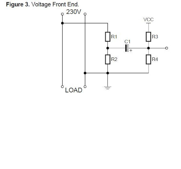

Voltage Divider
In the voltage sensor section you say:
"One AC-AC power adapter with a 10k:100k voltage divider across it to step down the voltage further and 10k:10k voltage divider to bias the ac voltage to keep it within the 0-5V range of the arduino."
I don't see this on the schematic however? Is this still required?

Hi again Trystan - I managed
Hi again Trystan -
I managed to get a simple non-invasive whole-house monitor going, but it's very rough still. (The IR pulse detector doesn't work in the sunlight) :) But on the upside it was simple, and cost almost nothing for parts aside from the Arduino. And it should be very accurate since the meter is doing all the hard work for me.
As I said, I've been gearing up to do a CT monitor setup like yours, but I realized a couple things... in the US we have 2-phase power, so of course we'd need 2 CTs on the mains. But I'm wondering if, for voltage & power measurement, we would need to measure across both phases to be accurate.
Further, I wonder how much the voltage differs on different branch circuits, and whether a single point of voltage measurement is sufficient for computing power on each of the branch circuits...
I guess I have more reading/studying/researching to do. :)

The IR pulse detector method looks very neat, nice work! I like the pachube graphs you've got going too.
That's a good question on the voltage, If one leg is heavily loaded then it should have a slightly lower voltage than the lightly loaded leg. It would be interesting to see by how much the voltage varies on each leg, and whether the difference warrants making a second voltage measurement? I imagine the drawback of making a 2nd voltage measurement as well as already measuring two leg currents is that you'd start loosing a fair bit of resolution in time for the sampled waveforms...
I made a 3 wire single phase LTspice simulation to better see what is going on here which may be useful: http://openenergymonitor.org/emon/sites/default/files/3WIRE.tar.gz
I tried to see if I could find anything on the internet on differences in voltage, but didn't come across anything, I probably haven't looked in the right place as is with these things. If you come across anything or do some measurements I and I'm sure others would be interested in hearing about it :)

Another question: Looking at
Another question:
Looking at the schematic how can you have 5v in and gnd tied to the same leg of the ac input voltage? I am confused am I missing something.
5V and GND and the 2
5V and GND and the 2 resistors produces a voltage divider that outputs 2.5V - which biases the ac input voltage to "center" around 2.5V instead of 0V and therefore the voltage at the arduino stays within the range of 0 to 5V, does that make sense?
Yes I agree that is what you
Yes I agree that is what you are trying to do and I understand that part. My problem is that I believe you would need a couple things to achieve it.
1. A cap in series to ac couple the signal into the arduino.
2. GND on you divider needs to be tied to the other leg of your ac signal.
See link for pic of what I am describing. This is taken from single phase power meter appnote465 on atmels website.
Schematic
Ok Got it figured out. I see
Ok Got it figured out. I see what you are doing now I redrew the schematic. It makes sense, the only missing component would be a series cap on the adc input. Originally the way it was drawn I didnt understand how the divider and biasing worked.
Hey, sorry I
Hey, sorry I misunderstood/misread your first question, you were referring to the voltage measurement part of the circuit right?
Thanks for the link to schematic and app note I had a read through and studied a couple of other app notes as well, they all as far as I can tell seem to be using half-wave rectifier circuits for the power supply which if I''ve understood correctly allow's it to be a grounded supply. The power supply circuit that I'm using uses a bridge rectifier which means that it is floating or ungrounded. I think maybe I'm wrong in trying to use a bridge rectifier circuit instead of a half wave power supply circuit and this is probably the source of the interference I mention above, so thanks for pointing out the app notes.
Here's the LTspice circuit for the voltage measurement and power supply circuit above, it seems to give a near-sinusoidal voltage output: Vmeasurement.tar.gz
and here's the LTspice circuit for the half wave rectifier circuit that you linked to with the ac coupling capacitor, it also seems to give a sinusoidal output but maybe a bit better than the bridge rectifier circuit: halfwave.tar.gz
So I think I will try the half wave power supply for the next version of this circuit with the ac coupling capacitor, although the current version does seem to work: the real power, power factor and apparent power measurements seem to compare well with the values I read off the plug meter.
In your last post you mention needing a series cap on the adc input, is that in the same way as the ac coupling capacitor with the voltage divider after it? a series cap direct to the adc input without the biasing voltage divider wouldn't work as it would remove the dc bias, right?
Thanks for raising the questions about the circuit, I think I have learnt a bit more from them, and will post up the results of the half wave power supply circuit as soon as I get a chance to build it.
Yes I meant in series with
Yes I meant in series with the divider after it, not direct to adc input.
