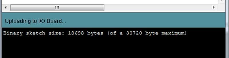

4. Whilst holding the reset button, select the upload icon, and you should see this;
5. Keep the button depressed until the sketch has compiled, and you see this message;
6. Now release the  Nanode's reset button, and provided you have selected the correct board and COM port, you should see a flurry of activity as the Rx & Tx LED's flash.
